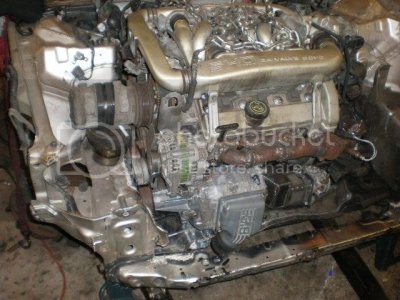

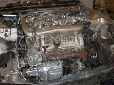

PB300240
PB300249
PB300247
you can see the remaining thread in SHO related,
You see after last picture, I had to cut that bumper 3" in to get the double core radiator, SHO fan, and AC condensor, so there is almost no room for the intercooler but I have figured a way to do it by removing the hood latch assembly, that should make enough for the intercooler.
So putting ported M90 is near impossible now since the casing is 1" larger, I have to stick with what I got. I talked to my SC expert, he's got a 1995 T-bird with a 2.82" pulley and he claims his engine is able to go to 6000 rpm, he is running a 3.07 ratio which = 18,443 making 16.5 psi for many years.
