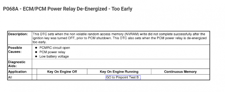

Went to start my car and wouldn't start. Bunch of clicking underthe hood. Tried again and it almost turned over. Thought battery was bad so put jump pack on for a bit and then it started. CEL was lit with a P068A code. I googled the code but I'm no mechanic so I have no idea what it meant. Any help appreciated

Sounds like simply a bad ground at the battery terminal to me. Your jump pack just bypassed the battery is all.

That BMS is a PITA - HA! Sound like it - with such a hot summer - I bet many folks batteries have issues. Even if they are just a couple years old, welcome to the South. Your car battery is dying and the BCM needs a reset.
Read this thread - watch video: https://shoforum.com/threads/battery-issue-and-new-ticking-noise.145706/
1694461852940
B2 CHECK THE BATTERY AND CHARGING SYSTEM
- Check the battery and charging system voltages. Refer to the Workshop Manual Section 414-00, Charging System, Inspection and Verification.
Are the battery and charging system voltages within specification? Possibly 13.5V+ or hopefully/preferably 14V+

Thanks my friend, I'll try that, I have several problems with my SHO 2016, I hope it's one less haha
