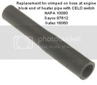

Use one of these to transition from pipe to the engine block:
SHOcelopipeheaterhoseNAPA10080Small

I cut the crimp off behind the silver part and slipped the 5/8 end into the connector in the block and the 3/4 end where I cut the pipe; seems to fit ok, but I need a 2nd clamp for the 3/4 end. I only had one clamp and put it on the 5/8 side and I seem to have a leak. Not a big deal.

IIRC, the connector on the block is larger diameter than the pipe and should get the 3/4" end. The 5/8" end goes over the pipe. You shouldn't cut the pipe behind the crimp because then you loose the bead formed in the pipe that helps retain the hose. But since you did, no worries, providing plenty of overlap and double clamping it should be sufficient.

Yeah, initially I cut THROUGH the crimp but then saw that the smaller end of the hose would not go over it, so I cut just behind it. Yes, my mistake, the larger end of the hose fit perfectly over the engine block part, and the smaller portion fit over the tube just as it curved into what used to be where the crimp was. I do need a 2nd clamp over the smaller end as I noticed it was leaking when I tried to start the car last night. I only had 1 extra clamp left (went on the larger end to the block), so I'll go pick up another one tonight. Hopefully it holds well enough and will do the trick. If not, I'll source a used/j/y hose.
