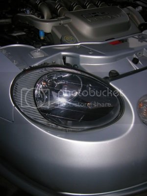

I just took industrial application scratch remover to my headlight lenses. One of those 3 step things with differing grades of compound. I did it by hand in about an hour, making them quite new looking again. You could probably do it both faster and better with an electric buffer, but I did not feel like hauling one out.
Oh, the 3 step kit was maybe $10 and I used perhaps 1/3 of the total material in each bottle, so a $3 fix or so.
