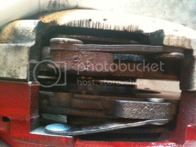

Does this look correct for a SouthBend Stage 1? The strap and rivets don't look as good as the ClutchMasters I'm taking out. Is this normal? I've not heard anything bad about the SB clutch, but I certainly expected it to be as beefy as my old CM. Red is the SouthBend:
IMG 0146
