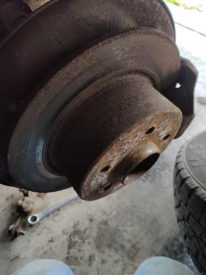

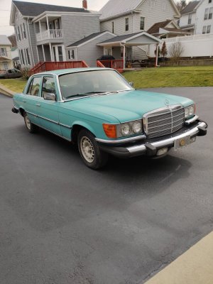

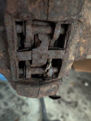

Actually been restoring an 80 merc diesel we picked up recently. 1 brake worked as we drove it around roadkill style. All others rusted that they wernt even moving components anymore
