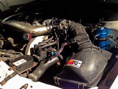

I have been running my 89 like this for a few years now with no issues. I just have to remember to empty the catch can at every oil change or else it does build up sludge. The amount of oil kept from going back into the intake manifold is incredible.
The hose connecting to the bottom of the throttle body is the one coming out from the V of the block. In order to install a catch can you will need to remove the intake manifold. There is no way to reach that hose with the intake in place and the existing hose will not be long enough or flexible enough to use with the catch can.
18684130891 a9b3b8d9f2 bimage
