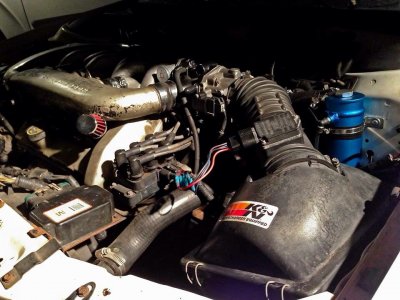

I have been running my 89 like this for a few years now with no issues. I just have to remember to empty the catch can at every oil change or else it does build up sludge. The amount of oil kept from going back into the intake manifold is incredible.
The hose connecting to the bottom of the throttle body is the one coming out from the V of the block. In order to install a catch can you will need to remove the intake manifold. There is no way to reach that hose with the intake in place and the existing hose will not be long enough or flexible enough to use with the catch can.

I wouldn't run a catch can,I'd go ahead and install a clamp on/push in breather where your oil fill cap is.....block off the valve cover vent to your intake at the valve cover ****** and at the intake.
I will try to post a pic for you on the crankcase vent hose but it is the large hose that runs to the bottom of your throttle body. I would install a clamp on filter to that hose as we'll.
This is what I did on my 95 ATX along with deleting my EGR and the bypassing the TB coolant lines(simply looped).
As soon as I read about blown cam seals and seeing that most 89-95 SHO's don't run breathers,I knew it was an easy improvement I'd be making.
It's all for emissions anyways(no matter what some folks think). So if you don't have to worry about emissions,I think it's a no brainier.

I have no idea on part #'s but I could prob find out.....both are clamp on filters,the one in the valve cover just happened to fit the oil fill and it had a slight angle to it.I bought Green USA filters(made in PA). I've found them to hold up the best for crankcase vents and still very reasonably priced.Superior to K&N....
They also have a lip at the bottom that allowed me to basically screw it into the valve cover. My tb to crankcase hose was rock hard and i tore it getting it off so I cut maybe 1" off and was able to Just clamp my filter on. It barely clears my intake w/ ShoSource 1/4" spacers but it does clear. Once the intake is on,it pretty much disappears.

How long have you been running these filters like this? I would like to see a pic after they have several thousand miles on them. I get about a quarter quart of oil in my catch can every oil change. If i removed the catch can and just added a filter to the hose coming from the crank case like what you have it would quickly get saturated with oil and then be dripping all over the hoses, harness, and trans before making it down to the pavement. The Blow-by needs to go somewhere, whether into the intake, into a catch can, or on the pavement. Adding a filter doesnt stop this from happening. 95% of the oil/sludge that gets into the intake comes from this hose.
The port coming off the valve cover has baffling under the valve cover to prevent oil from splashing up and out of it and saturating the filter. The oil filler hole does not have any baffling. Unless you get an actual Oil Filler Filter Cap with built in screens and a check valve i can see that filter getting saturated and dripping oil all over the exhaust. This setup does not seem like a good idea at all.
