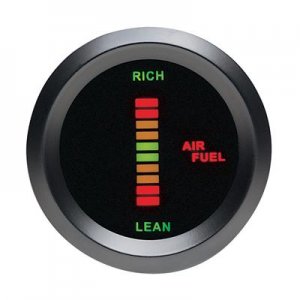

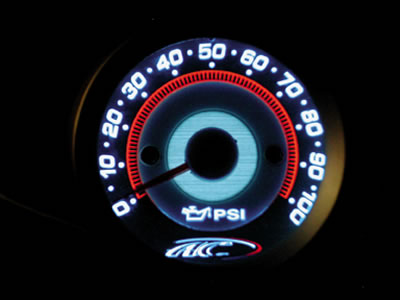

What makes them not very accurate? I plan to run nitrous so I want to keep an eye on it. Does the A/F gauge just splice into the factory O2 or do I have to buy the "special" O2 that they make? Thoughs are AC Autotechnic S7 racing gauges you can check all of them out here http://store.summitracing.com/defau...&Ntk=KeywordSearch&Ntt=Air+Fuel+gauge&x=0&y=0

This thread has a link AND video to a wideband 02 sensor. These things are a minimum of $300, whereas, I got my a/f gauge from Summit for less than $30.
I can't justify the extra $300 or so, especially since my gen.1 needs a Quaife and a twEECer more importantly. So I took the 91 to the dyno and had the a/f readings done there. It was running definitely on the rich side... which is obviously SAFER than lean. Thus I opted for the lesser a/f gauge. I have NO idea how accurate it is... it DOES SEEM accurate at WOT.... (a bit rich, as the dyno testified to)
Here it is:
Sum g2986

Wow $300 to do that, I have better things to spend my money on. Thanx for giving me the heads up on that. So is the factory sensor a narrowband and can the A/F gauge hook up to it or do I have to get a new O2 and have a bung welded in?

How do you hook up an oil pressure gauge? (electronic one) Do you have to tap the block or anything?

Most people hook up their oil pressure gauge by just replacing the sender already tapped into the block that goes to the OEM idiot light with the one supplied with the oil pressure gauge. It is right on the front of the motor, and very easy to access.

as for the a/f gauge, it is an easy install, at least it was in the v6. No need for an additional sensor. You just have to splice into the right wire. Some do it right at the 02 sensor. I have read that its better to splice into the wiring on the computer side, rather than the 02 side. On the v6, that particular wire just happens to be running up by the oil dipstick tube, in splitloom... EASY access. Don't know about the v8 though.
