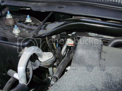

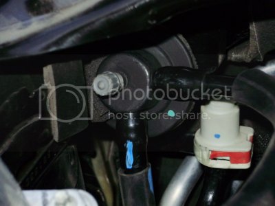

I just got my 2010 Show back from the delar yesterday after them having the car for 2 weeks having the gas smell repaired, this is the second time that i had to bring this matter to there attention the first time they could find nothing wrong with the car.
2 weeks ago i was stoped and fueling the car and thought i would open the hood as the smell was getting worse and i found that there is a part of the EVAP emmisions system that is located right nest to the firewall on the pasenger side of the car that had a oily residue on part of the device, upon getting a good whif of the residue it smelled just like the gas smell that had been driving me crazy ever since buying the car in december.
Delearship called and stated that indead that part was leaking fumes and that the mechanic deamed the car unsafe to be driving so they wanted to keep the car and order replacement parts, the new part has to have several hoses replaced as well and this took some time getting the parts rounded up and installed.
So far have drive the car about 75 miles since the repair and not even a whife of fuel smell getting back into the car or even smelling any on the outside of the car. i hope this info might help others that are having same issue.

Sonny, can you take a photo of this part?
