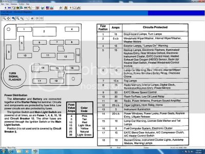

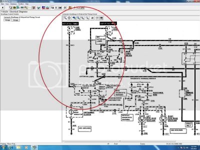

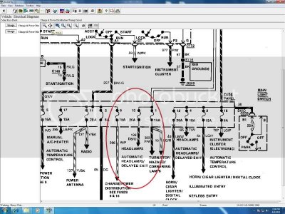

According to the 89 EVTM:
DRL was not offered on the 89.
F10 goes ONLY to the MFS (DB/O wire) and is only used for FTP.
