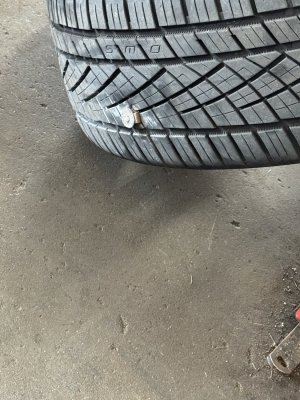

Thats not much of a difference and in reality the tires are never truly to spec and different wear along the corners is more different than this. Its either the left or right on the front that wears faster anyway because of the torque and weight. The 18 inch rim is perfect but im sure the person who wants a full size spare wants the same exact rim to match. I just had to use my little scissor jack yesterday. They work very well imo if the road is flat i guess. I just drove to the closest tire shop when i heard the bolt clacking with every rotation. Popped the wheel off in the parking lot and rolled it in to be patched.
