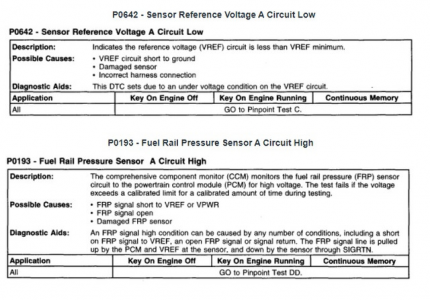

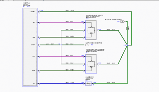

Hey guys contacted my local mechanic on Sho repairs and minor progress, he pulled codes P0106,P0234,P0642, replaced both MAP sensors, before I take it to the dreaded dealership what are you guys thoughts . Thanks
13,265
Are you running a tune? was the MAP replaced with an incorrect sensor (like 3bar vs 2bar)?
Is there 5v to all the circuit connections? THere are only a few spots in circuit below.
Were the old codes erased after the new stuff was put in? You don't want to chase old codes that may have been resolved.
Use the decision tree in 1st code to determine the next place to check/action to take.
If there are no correlating codes then go to next code.
P0106 code decision tree in this thread
P0234 code decision tree in this thread
