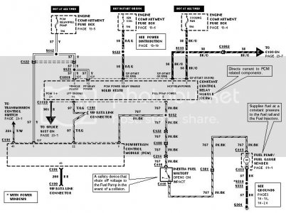

OK. where to begin???
I took my car to a local mechanic to have a safety inspection done so i could get it legal here. When i got to the mechanics lot and turned the car off it never started again. It was running a little hesitant on the way up there. So after paying him and a tow truck a lot of money to look at it and move it back to my house the mechanic tells me that the fuel pump and ccrm is bad. I replaced both at a hefty cost. Even got a new ccrm. Still the car does not start.
When the key is turned on b4 start the fuel pump does not engage. If a hot wire is run to the #5 wire on the ccrm the fuel pump runs. What should I be looking at now as the source of why my fuel pump wont run when key hits on position?
I checked all fueses in the fuse box in the car and under the hood. None are blown.
I am really clueless as to where to begin looking now. Any help would be GREAT! This car has about 2 weeks before it goes to get crushed if I can not figure this out.

Knowing what year and transmission your SHO has would help quite a bit. Offhand, since wire #5 is power to fuel pump in J, D, and M code CCRMs, if the fuel pump ran with 12v applied to it, that rules out the fuel pump and the emergency cutoff switch. That leaves the CCRM (again), the ignition switch, or the wiring between the ignition switch and the CCRM.
With the key to ON, check for +12V at the wires indicated by the charts here: http://www.shoforum.com/showthread.php?t=75065. Look for the big letter on the CCRM itself to figure out which chart you need to look at. It'll say either J, D, or M. Looks like it's wire 12 (yellow) for all three.
Once you let us know what code CCRM you have (and year/trans of your SHO), we can help you out more. This should be a fairly simple problem to fix.

Start checking for +12v at all the places indicated here. If you're missing it somewhere with the key to RUN, there's your problem. If you're not getting it at the fuse, then a fusible link melted on you.

CCRM Fuel Pump Control
Pin 15 is ground.
All versions provide output on Pin 5.
Types D and J:
(93-95 ATX, 94-95 MTX) CCRM has a single FP RELAY. B+ power is supplied to the common terminal via pin 12. The FP RELAY is energized by the PCM (or grounding the FP TEST pin on the DLC) by grounding pin 18.
So check to make sure you are getting 12v positive on pin 12, that pin 15 is always grounded, and that when you turn the key to on pin 18 is grounded (at least momentarily when the car tries to prime itself) as well.

Well, to test input power, you can simply disconnect the connector from the CCRM and probe that wire (red to the wire, black to ground [any piece of bare metal, the lifting eye works well - negative battery post is best]) to see if there is 12v coming into it. With the key in RUN, I would check for 12v at wires 8, 12, and 13.

I finally bought the meter and made it home to do some checking. I checked all 12V spots on the diagram. I got to #13 wire and found the problem.
I unbolted the harness from the ccrm and found that the #13 and #14 wires had been pushed back inside the wire harness and were no longer making contact to the ccrm. Pulled both of them back out and bolted the harness back on the ccrm. Turned the key to success! :woo-hoo::woo-hoo::woo-hoo::woo-hoo::woo-hoo::woo-hoo::woo-hoo::woo-hoo::woo-hoo:
