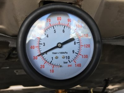

69a3c1a7b01df970c2a67ec06859b4a7
Key on engine off.

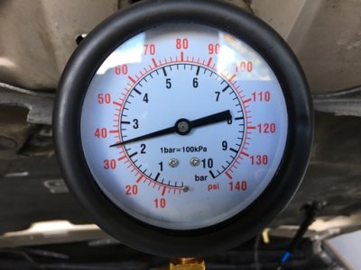

A58b8e9e7d8415293647378d5433b8b1
Idle (before was only 28psi).

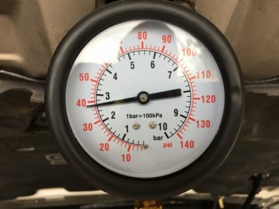

F4b3360392bddd69d75cc0248a9c3c7d
Vacuum line disconnected (before was only 35 psi).
With that problem resolved...onto TB and WP, VC gaskets, changing all fluids, and a ton of other items.
