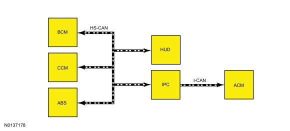

Collision avoidance uses the Cruise Control Module (a radar unit in the bumper area) to find a target and see how fast you are approaching it. If it thinks a collision is eminent it will flash the HUD leds and possibly activate the brakes.
