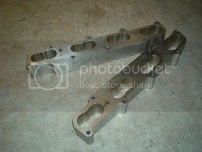

any chance you can post of pics of how the lower intake is set up i have plans to do this to mine here in the next year...
thanks!
pics for sure! lol i also wanna see the bottom of the upper intake deal.
Here are the pics of the lower risers. I will try to post pics tonight of it installed on the car. I've been fighting with my powdercoating colors the past couple nights for the other pieces. The silver vein was too dark, and the antique grey was too blue-ish. I may end up end just doing a hammered finish on it and calling it a day. 002 16

First off.. is it smart to just have an "open air box" for the forced induction to the cylinder heads? If memory served me right, I think something should be a little "organized"... I dunno.. tell me how it's done.. I'm learning as I read.
Also, did you make your lower risers yourself?
SHO U UP
SHO Guru
Dec 10, 2006
1,506
231
Virginia Beach, VA

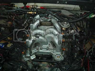

Doug at FPS designed the kit to start off with. All parts were designed by him and his machinist, so I cannot take any credit for the parts. IIRC, the path to the heads still have their separate paths from the intake. Be it the SHO, or any other vehicle. I know Eric's intake houses his injectors and such, all mine has is inserts for the bolts that hold it down. So once the air leaves the blower it winds down the elbow in the upper intake. Now we are know the SHOs are famous for thier runners, surge tanks, secondaries, etc. Once my pedal is mashed, the secondaries open all the way. There are none closed like normal up til 3400 rpms. Mine are kicking full force when I hit the go pedal. So, each chamber is pulling air flow down at the same time. And thats the idea of the spacers I pictured. I can see why you asked the question, and perhaps Doug or Eric will chime in also to verify, add or correct my logic here. I know on my trucks, it's basically the same way. Only difference on the L is it passes thru an interccoler then into the valleys and on my big truck, it passes thru the upper intake, kinda like the SHOs, with each individual runner:011
Its hard to see on the Lightning, but the valleys are in the sides of the upper intake. There are no runners so to speak of.:001 7
I guess you could think of that upper intake now as a surge tank, minus the runners. Hope this helps. :wave:
