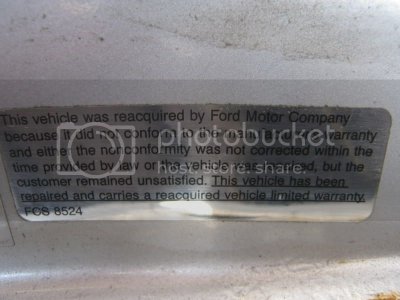

I shoulda known this SHO was going to be trouble when I noticed this sticker on the driver's door.
IMG 0925
The damn car was a lemon from the ******* factory!

EDIT: OH S***! You got a lemon buy-back. Ouch!
