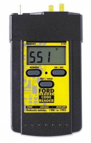

If you have difficulty with the flashes on the dash and whatnot get the
1663091601216
to make life easier

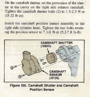

I'm gonna reset the computer and perhaps reapply the thermal paste to the DIS as well as check/clean connectors. I already bought the cam sensor awhile ago so I'm thinking might as well install it. The seal for the cam sensor is inserted behind the cam shaft shutter?

there is no seal for the cam shaft sensor. Only a seal for the camshaft itself

look at the Shophoenix link luigisho posted and you can see where the seal is located
