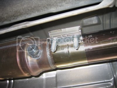

The U clamps are designed to distort the pipes, so you cannot take them apart once the clamps have been tightened. That's probably why they're leaking - you didn't tighten them enough. If you want to be able to take the pipes apart again, you need to get band clamps. They should seal better too.
Tn IMG 7881
Tn IMG 7881

That's not my car. I just stole the picture from Google to show you what they look like.
They shouldn't be tough to find online. Search "exhaust band clamps" on google and see what you come up with. You could try a parts store too, but I don't remember ever seeing that type of clamp in a store.
