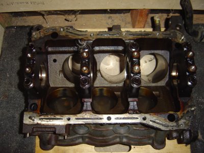

Here is the underside of a 3.0:
Block20120 20Copy
If there are more ribs around the freeze plug areas it's a 3.2.
