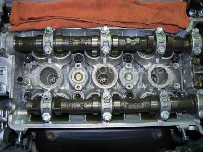

Whats up show fans??? Finally going to fix up my 89. The car still ran when I bought it, but the oil on the dipstick looks really really milky. Found out that it has a leaky heater core so I bypassed it. But b4 I got it someone overheated the crap out of it. I'm going to get the heads shaved as long as they didn't crack. I'm thinking of getting a turbo down the line and plan to put in some pistons, valves, and cams. Anyone with suggestions on what to get for the rebuild would be helpful as this will be my 1st attempt at a rebuild.Oh yea I live out on the big island of Hawaii, so just getting another motor over here would **** me on the shipping..

Thats the most unhappy looking cam i've ever seen. Ive seen cams sitting outside that look better then that. Geez guy, i hope it cleans up well for ya.
Anyways, rebuilds for these motors are not cheap. pricing my 3.2 is coming around 1500 just for parts. (i.e. gaskets, sensors, bearings) no labor. Atop of that you cannot buy a set rebuild kit, you'll have to piece it together yourself. Theres also alot of things that are hard to find or simply not made anymore, like thrust bearings for instance. Unless you plan on putting down big power and using some wiseco pistons i really think the best route would be to find a 3.2, do a full 60k and drop that in. Shipping will **** you as stated but i'd be willing to bet you a motor rebuild would cost more then purchasing a decent to good shape 3.2 and floating it across the drink.

the 3.2 block is indeed stronger... extra castings on the block.. not many people know about it but area91 had mentioned it to me and shown me.
you are missing shims in that pic and its really rusty in there... send those cams in for regrind for sure.

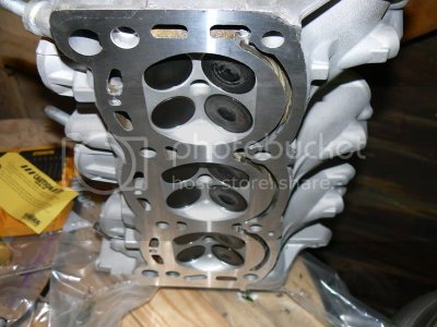

As far as cleaning up the heads... have the machine shop do it.. should only be 10 - 20 bux and they'll look like this...
Front 1
Rear 1
P1000497
:thumb: The best 10 bux I spent on the car so far! :thumb:

I used Simple Green and a hose and they looked like that, sans the mating surface where it looked like crap because I can't plane/clean gasket properly.
