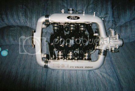

i just wanted another opinion but i have my intake off and i plan on painting the tanks black and the runners blue with high temp engine enamel. but i cant find real pinstriping paint to paint inside the sho,ford and dohc. so i picked up some touch up paint. if i lay 2 coats of engine enamel down, then touch up paint in the engravings, and then cleared over the whole thing with high temp engine enamel do you think the touch up paint will be fine? u think the paint willhold up?

Yea it'll work... what I did was get Testors Enamel for the Ford logo... enamel was enamel was my theory... it held up well. :)
Myintake
That "Ford" is actually Silver, while the rest of the intake is "aluminum" :)
Edit: X2 on what Bob said... without toothpicks it isn't possible... well maybe some of those $10 brushes.. :)

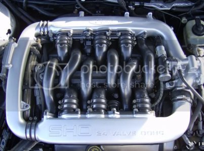

Don't bother with the high temp stuff.... Just some good 'ole Duplicolor Truck, Van and SUV paint will hold up better (speaking from experience).
I like to sand, paint, sand, paint and then a final spray with the last few passes as a 'wet' pass. After I let it dry, I bake it in the oven for 20 minutes. When it cools, I light polish (maybe some wax) will bring out the 'bling'.
For the lettering, I originally masked the general area, did a quick spray and quickly remove the masking and wiped the intake with a rag soaked in turpentine or the like. Another quick polish where you wiped (may not be necessary) and it should clean up any damage and you're done.

I prefer wheel paint over high temp engine or regular paint, though I will say my current paint job is wheel paint on the plenums and high temp engine paint on the snakes (I already had it laying around).
