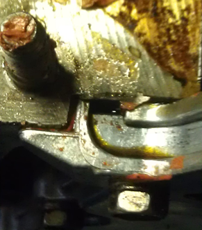

The factory puts the seals in dry. They eventually get rock hard, exposing a design flaw in the engine. Pic shows the front edge of the rear main seal carrier with the groove for the oil pan gasket. Notice that there's a small rectangular hole at the end of the groove. This is plugged with a tab on the gasket, but it eventually leaks from this point.
Solution is to put a dab of gasket sealer on the block where the ends of both gaskets sit. Dielectric grease helps the gaskets stay in place during installation.

That picture looks like the front timing cover oil pan interface, not the rear of the engine unless I'm thinking wrong. Regardless, the tab slot is probably similar on either end of engine.

That almost looks like the front timing cover, not the rear of the engine unless I'm thinking wrong. Regardless, the tab slot is probably similar on either end of engine.
Somewhat similar, but I took the pic and it shows the rear main seal carrier, not the oil pump.

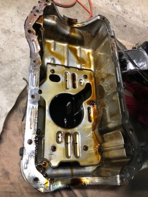

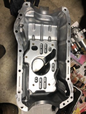

Removed oil pan; found front and rear oil pan seals petrified, but did have a tan colored sealant in corners. Have replaced them with Fel-pro set and added sealant on corners, hoping for the best. Will update outcome.
Rod bearings were showing copper; upper halves moreso. Replaced them with Clevite std.

Leaking at back corner now, not on end any more. Must have messed up my silicone getting the pan in place. With my car on ramps, the oil drain hole near back corner kept wetting the ******, even after cleaning and wiping. I think that oil spoiled my seal there.
13,266
Could be. It's a tricky line it up with all the goop on it. Is there a way to get it level(ish) with jack and jackstands? Unless you are using 4 ramps and I have it pictured wrong.

It's tough to get the oil pan seals in place during oil pan re-installation. I give them a coating of dielectric grease.
First, I appreciate the responses here in the forum, very helpful. Finally finished after holidays. Also replaced rod and main bearings and #3 main shoes with crankshaft in place...a job. The Right Stuff worked well in conjunction with gaskets for #1 main and #4 main ends of oil pan.
No more oil leaks.
Note: Oil pressure switch is accessible from underneath with oil pan off and easier to get at than from topside reaching down blind. Cheap part...another common source of oil leaks
