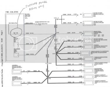

LOL ... Yeah, there could def be stray voltages from the meth kit install if you spliced into an existing circuit. An example from the HOW-TO that bpd put up on his meth kit install:
