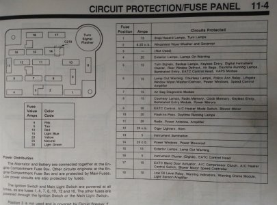

Per the fuse box pic he sent, assuming valid for '92:
Fuse 8 - I don't see a trunk light that is active, is there a level switch or something that controls a light there? Chilton's shows a mercury switch.
Fuse 6 - Diagnostic warning lamp, is that active when ignition is off? I do have an airbag light that blinks when the car is running but not when off.
Fuse 11 (largest drain) - radio/ premium sound (I don't have the JBL, was that "premium"?) / power antenna My power antenna doesn't work, but that usually stopped trying after a while I thought. I don't hear it grinding or anything. The drain was present though the radio was off. I suppose I could just yank it out.
Fuse 17 (smallest 40mA drain) - A/C compressor clutch and the blend door actuator, is there a separate clutch "EATC compressor clutch" that operates the EATC somehow?

Sorry I posted the fuse panel for a '91 specific.
I, would for giggles pull the 'courtesy' bulbs from the trunk, hood & glove box & test the elec. drain again. If you are tesing the fuse with any of the doors open then you are going to get draw on the courtesy light fuse which also carries the clock, radio, keyless entry lamp & power mirrors (15 amp).

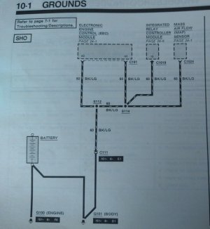

Can someone describe please the location of the PCM ground for me?
Bonus if you have a picture or diagram, but I can follow directions.
I'll go back into the archives here to follow up on the airbag light before I ask questions on that, I think I remember past discussions.
Ta2dResqr
Dec 10, 2020
1,208
1,144
Central Ohio
G101 (SHO): Center of LH front fender apron, near battery
G100 (SHO): Lower LH front of engine
G101 is Body ground, G100 is Engine Ground. Both are for the ECM.
BaySHO Performance
Feb 25, 2001
902
678
SF South Bay

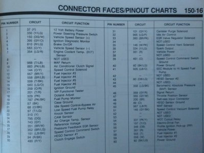

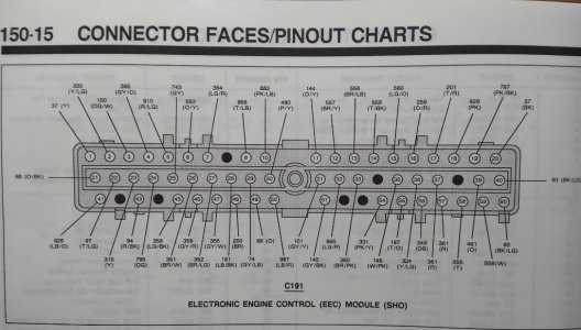

Paul, these are for a '92. ECU pinouts:
ECU Pinout 1ECU pinout 2
Pins 40 and 60 are the grounds:
ECU grounds
C111 and G101 are between the battery and the fender:
Component location 2
