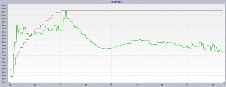

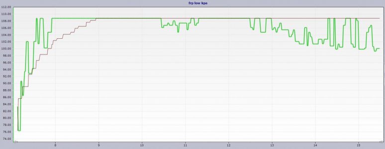

Brad is still tuning but he's super happy about the pressure staying way more stable and here is a log to illustrate, everything is 100% equal except for the BAP. The tune is the same before and after, so it's easy to see the improvement:
Charts are isolated to a 3rd gear run from 2k RPM to 6k RPM. Showing:
- LP Pressure DSD (Brown)
- LP Actual (Green)
Without BAP, you can see how it just can't keep up with the requested pressure:

With BAP, it can still use some help at the end, but way better:
KmjgfmVexmKHJAwidth1024height397cropmodenone
Stock, the fuel pump driver module never puts more than 14.10v to the pump (actually higher than I was anticipating). The DW300c is stable up to 18.00v, leaving almost 4.0v on the table. Right now, I am using a 0-5v trigger input from the pedal position sensor and have it ramping from 14.5v to a max of 17.0v at WOT.

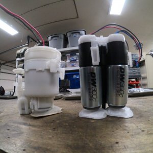

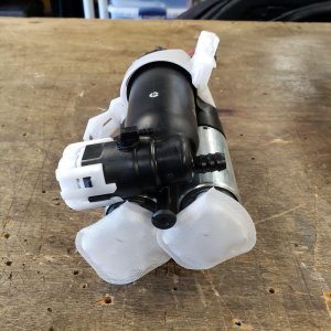

sssssshhhhhhhhh! here's my "other" LPFP project that is ongoing...but don't tell anyone yet ok, LOL (whisper):
Not even sure it will work yet, but here's a sneak peak:
Y6TcxUiCzrEjLwidth1024height1024cropmodenone
3dMAVeai0YpZfwidth1024height1024cropmodenone

Would someone like to take a stab at making me understand/believe why any of this is relevant and necessary to feeding a positive-displacement mechanical HPFP?
And you know I have to ask- are you still rocking that OEM fuel line?
y4meywBlX6wh5VH8OlNS_02yyhSOgAj99x4yKhoaueaBFJJ2-GXfbmecQ_5qGM_GwBs1rom1U7EvOIaHKx8v3W0Rx6YDuYh-5MAwMMLdBrAMs6fbya0UKOgCvKcO_1uu3RdPuu4iS_yUh4OOoPdOnQCyDLhmUl6S2aMDj5Xyi982tpA_Qe9WTAY1L5El534Ab-r
y4mtcyF_J77pBB9QLkYPbxhOjru1hedtijKoiK8-zeW5tdA2xIAV7lhSmePviEW4trLSp8Km99GX0EIYv5FLeYDvf3aeANeH0w6YBipSPnxE4acnvE_Dva5HKFNexCP4IPXZvwa2UMFLMENpCiRf7rqN4QiizLWwAvzo6sRB8EtHUN1WZAFiYoOKhG_WNDvPa9l
Two is always better than one so this clearly WILL work. Anyone who knows anything, knows that.
