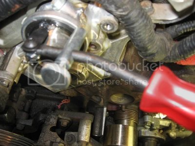

There's a proper tool for every job. ;)
Don't get too excited, it won't work on the rear cam seal. :fit:
