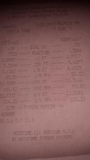

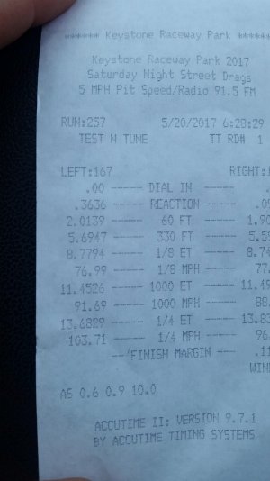

Today's the day! I finished up the thermostat and 3 bar this week and got the new tune intalled.
The weather today is 68 degrees with 0% chance of rain. I'm going to make the drive to the nearest strip, which is Keystone raceway in New Alexandria PA.
From what I can understand I need to power brake it up to 2000 rpm's, and launch from there in drive with the traction control off correct?
Any other tips? Should I lower the PSI in the tires?
Thanks fellas! I'll update this thread after I get back.

What was the DA?
How did your launches go? How did you stage? Seems you have room to improve the 60'

Shallow staging is rolling into the lights unto you are just tripping the staged light. It will increase your reaction time but cut your et.

Make sure you give it time to build boost. Ur 60ft are killing you. Stall it for 3-4 seconds before launching. +1 on shallow staging

Please explain? Right now I'm staging, and holding in the break and revving to 2000-2200. Then just letting go of the break and hitting the gas.

You need to hold the revs for a few seconds for boost to build. If you are spinning don't think that's an issue, if anything you might try to launch at a lower rpm to avoid spinning

Ok, ya. That's what I'm doing. I only spin the last run, and it was minimal.
TheDecalGuy
Mar 8, 2017
83
49
Johnstown Pa
Two things worth mentioning. Those wheels are VERY heavy. And I'm a pretty large dude. So the cars probably at 4900 lbs.
