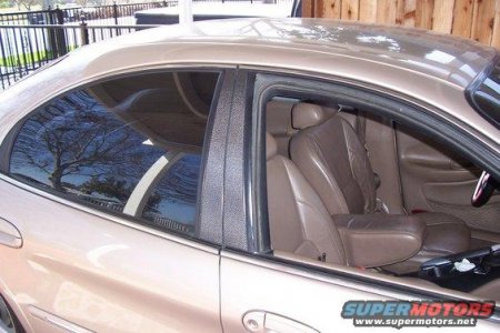

Most likely this is just carbon fiber style vinyl (like pinstriping) - the auction just shows rectangles, not custom-cut pieces. You can buy a 30"x40" piece here for $70. You can also buy 15" roll for $5 a foot here. Those were just the first sites to come up in Google. Besides, carbon fiber stickers = rice.

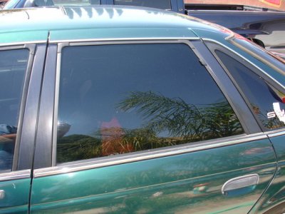

I've made my own overlays for chipped gen2 b & c pillars using 3m blackout tape (the same kind used in car factories now instead of painting). This material also has a protective top layer you peel off once the piece is in place. Not that hard, but you want to precisely cut the piece in place with a hobby knife and tuck it under the rubber trim edges with a plastic squeegee, and wrap it around the door evenly so it looks good inside also. The shape of the piece is unique for all six pillar locations, and not a rectangle. I was thinking of making templates and cutting some kits with my extra material and selling them on ebay, this would actually be a stick-in-place application instead of rectangles that you would need to cut, but also lots of work.

Well those dont look half bad. Would probably be a good solution to the normal chipping/peeling/fading of the pillars as they are now. Im just glad those things arent those god awful chrome plates that people are putting on their 300's now... :eek:

I know that they are just vinyl.... if they arent that would be great too.
Why would you show me whats avalible and then turn around and tell me its rice..... :shrug: and then you put tape on your car... regardless if its what the manufacture uses....
I dont think its "rice".... guess thats just a personal taste.
