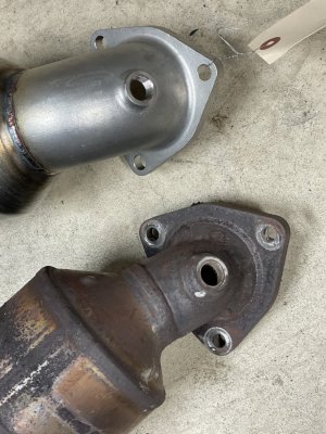

I looked at this myself, I love metal fab and almost get off on tig welding tubing. If you want a street cat on there its going to be hard to beat those because you're really limited on that rear turbo. People get all wrapped around the axles here online when you get into hi-flo/race cat not meeting emissions and in fact they are not and never ever meant to meet emissions standards. Venders shouldn't market them as such. Those road legal cats are big and not many choices to fit in that little space.
The PPE's make power right here, as seen in pic. Exhaust comes out of the turbine swirling, constricting it right there is a killer on flow. Funny, we learned all of this **** back in the 80s racing Buicks Grand Nationals. 30yrs later repeating all over again. --let me know what you come up with65127106499  3F8A3BB1 B445 4AFE ACA5 3AE3591964AE
