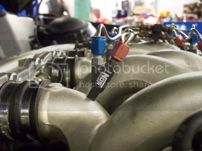

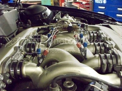

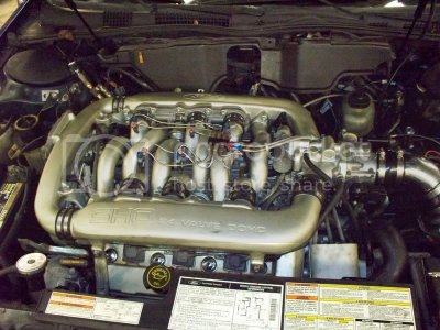

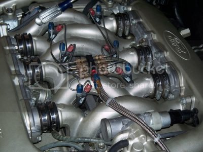

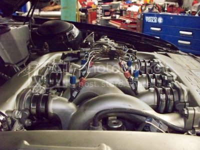

Well, someone finally picked up my manifold.
Here's a few pictures:
101 0163
Everyone and their dog has a bottle in the truck, but not many have the stones to back it up front.
101 0171
Anyone notice anything odd about this install?

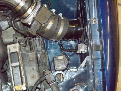

101 0167
Anyone?

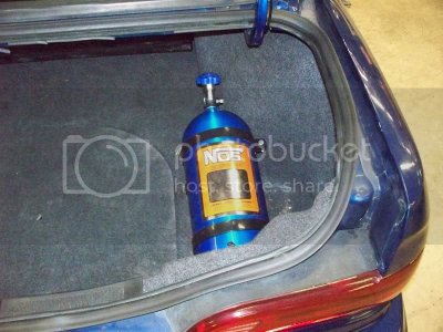

101 0172
Bueller?
101 0169
101 0168
101 0166
101 0165
101 0164

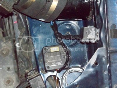

We installed a NOS Window Switch to run the system. The Window Switch looks at TP volts and engine RPM and only runs the nitrous system if the throttle is at WOT and the engine is between 3500 and 6500rpm. There are some other cool features about the switch that are not clearly outlined in the destructions. There is an extra driver for a second stage, so you could actually have a second stage controlled by a second window.

It's not in my car.
As odd as that is, that's not what I'm looking for.
I only had this one for 10yrs or so. There's no reason we couldn't build another one for you...
Beuller? Beuller?.......Frye?

Maybe that the fuel and N20 are reversed?
Now you want to see something really wrong?
Trunk:
Now let's look under hood ....
Hard to find a place for the ZEX control box.

But, no. There's soemthing odd about our nitorus system install on the blue car. I'm looking to see if anyone gets it.
