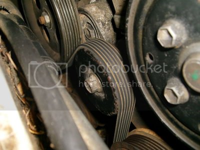

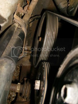

Well, it seems to me that the tensioner pulley is somehow not lined up right, knocking the belt off a little bit, making the first rib come off of the power steering pump pulley. I swapped the tensioner pulley with the upper idler pulley to see if it could be a problem with the pulley itself, Then I put the old belt back on, which I believe is a Kelly Springfield because the box was in the trunk when I got it (along with a LOT of junk and 2 brake dust covered slicers). The old belt has deeper ribs than the Dayco belt, and I think they are keeping the belt on the p/s pulley. Here's a few pics after I ran the car for a few min:

That's the pulley that used to be on the tensioner. You can see where the belt had been.

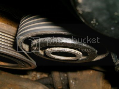

S7302752
Is the lower tensioner pulley supposed to look like this?

7,521
holy rust batman!
are you sure you had the new belt properly installed? it is easy to get the belt off one groove on one pulley, which can **** the belt pronto.
when you have the belt off, is there a lot of wobble in any of those idler pulleys? if so, that would cause the problem. or, if the rubber piece in the tensioner arm is bad, that could make the tensioner pulley run crooked.
the lower idler pulley looks correct to me.
