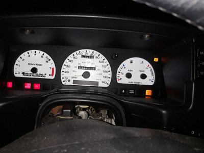

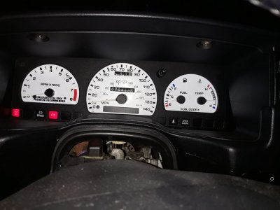

92 MTX. A majority of the lights dont come on with key on. A few more show up when i hold key in start position. Tried multiple clusters, x2js, and many bulbs. Also noticed I only have 1 connector in the back of the cluster, theres another spot in the back of the cluster where a connector goes, but theres not another connector behind my dash. My evtm shows one, but I am at a loss. 2 indicators lit up key in on position. The other pic is with me holding key in start position

There are most definitely two connectors. If you don't see the other one then you need to get under the dash and try to locate it.
