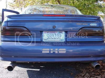

There is a spray out there called night shades it works great. I have used it. This is what mine looks like not a total back end shot but its the best I could find right now.

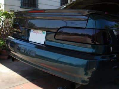

Sometimes with Night Shades it might take a few applications. It may also be a little uneven or rough so you might have to sand it down and put a clear coat on it.

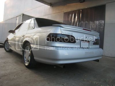

heres a crappy pic of mine got a better one somewere but cant find it rite now.........2 coast of NiteShade then 2 of clear

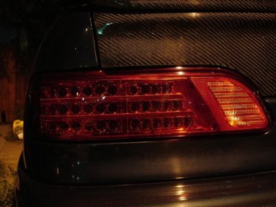

I've seen a few different LED bulbs that fit that socket, just haven't tried them yet. I believe I'll need a Grote flasher too to make that work.

i had led bulbs in mine and yeah you need a grote flasher to make it all work properly , without the grote in the turn signals wont even work, brake lights and all still work but no turns
