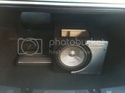

i think i have the lamest setup now
IMG 3257
that amp is blown so now its a smaller alpine amp with less power don't need anything crazy for an old pioneer 12" but at least it sounds awesome

I hope that's a plexi window on the top and not a hole where the previous amp was installed.

You didn't grow up in 90s car audio, did you? Plexi is essential to sweet sub boxes...
Actually, I did - graduated high school in 1993. I'm used to the plexi showcasing something, like over the front of a bandpass box so you could watch the sub cone. I'm not used to it showing the inside of an MDF box. That, along with the "amp is blown" comment lead to my question.

if I may...
a square hole chopped in an enclosure does not a port make. It's simply a hole. An enclosure vent is crucial in tuning for a peak at a certain frequency...for example, my older Earthquake 12" is in a 1.21 cubic foot enclosure with a 24" long, 4" diameter port which means the enclosure's now tuned to 35hz. You'd be far better off covering that hole with something or there's a strong possibility that sub could suffer from over excursion and eat it's own voice coil for lunch.

You can see the plexi bolted to the box in the picture if you look. :)
That's a premade generic box, leave the poor guy alone you meanies.
I sold my fair share of regular and quite a few super sized (I worked at Streamline Audio when we built the 1st Gates Bronco - 164.9 dB) most customers just want cheap and working and don't appreciate the awesomeness of super custom audio installs.
