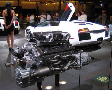

and then theres the BBK version of the intake, which just swapped stuff around some instead of just chucking the whole idea and starting fresh
mustangtuning_2093_353652672
center mounted TB, just that its single plenum for 8cyl instead of dual plenum for 6 cyl
also on the Center TB arrangement we have:
Ferrari Scaglietti
The Lambo Murci uses a doubled up version of the idea
Lamborghini MurciC3A9lago with engine
e36 M3:
the 88 Carrera used a single TB between dual plenums
