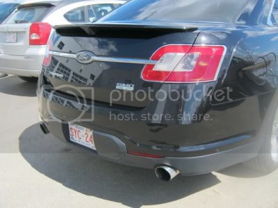

I've been trying to find some way to "customize" the Ford logo on the back of my SHO. Basically, I wanted a Black version of the Blue stock logo. Our good friend bpd1151 passed me a link the other day to a gentleman who does custom Ford logos.
After checking out his website here: http://planetauto.homestead.com/chromeemblems.html I discovered that he will not be taking orders until June for any more logos. Well, since I'm an impatient SOB I emailed him (Scott) and found out that he had a couple of leftover logos that he has already customized. The logo on the back of our SHO's is a 7" logo and this is what he had available in black! Lucky huh?
I think that I will order this although the 89.95 + 6.95 shipping price tag has me a little scared.....
Am I just being a cheap skate? What does everyone think?

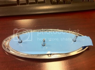

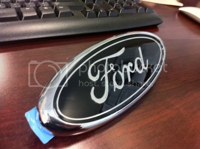

Well, I received the custom logo the other day and the good news is that it is of high quality and looks great! Scott at Custom Ford Emblems should be commended on his work :thumb:
D3139c9f
7cb51f44
E20f991e
C48fbd0e
There is of course a small problem that I was anticipating. This logo, although the right size at 7" is not from the back of a Ford Taurus. So the pins on the back won't align with the holes on the Taurus. I wasn't sure of this until another Forum member, Dramsey posted pics of his car all prepped for painting with the logo removed. I then noticed that the holes will not line up with the pins on my logo. Therefore, I believe that I will "cut" the pins and just use a really heavy duty adhesive to attach the logo.
A93c94fa
That's the plan right now however when I actually get down to the shop and start to try some things, plans may change. I welcome any advice with regards to getting this emblem to stay secure. :thankyou:

Andrew, great pics and thanks for posting.
It looks like there may already be an adhesive backing on the reverse side.
As far as the guide pins not aligning, you could do one of two things....
Use a pair of end cutters and trim off or cut down whichever pin doesn't line up, or.....
Bust out the cordless drill and blast a hole through the grille itself where the current pin lies in relation to the remainder of the backing portion of the grille.
Just a thought. Hey how much did those run you? Is this the same site I suggested? If it is, I think he put any future orders on hold 'til June 1st.
Hey Mike,
Yes I know that there is already an adhesive backing on the emblem however I'm not sure if that by itself will be enough to keep the emblem on well enough. I actually thought about your suggestion regarding putting a few new holes in the trunk where the emblem will go (not the grille as you said cause that's where my mobsteel grille will go :)This emblem is for my trunk) and I think I may do this.
This emblem is from the same site that you sent me and I am very happy with the product itself. 2 words of advice though...... First of all, get him to make yours out of actual Taurus emblems so the holes line up. And secondly, make sure that he can still do the emblems on our cars cause apparently Ford has recently changed the materials that they use to make their emblems and he can't work with the new ones and customize them.....
That was my fear and what lead me to just order a straight 7" in black from him. When I look at the emblem on my SHO, there is a thin plastic film around the outside that is starting to crack and look like shit..... I think that Ford is using a cheaper material for these new logos.
This emblem cost me $89 + shipping. Pricey I know, but once it's mounted, I'm sure that I will be happy with the results :) I'm sure that a set of white and black ones would look SICK on your car :thumb:

you should be able to go to any body shop and get some self threading nuts with washers on them to hold that bad boy down. when i worked for cheby they use to come with the new emblems.

Sorry I never put the pics up. I grabbed a couple from my phone right before they replaced the whole thing but unfortunately I had to format it and forgot to email them to myself. The pins definitely wont line up.
My suggestion is to cut them off and use the adhesive thats on the emblem. If it's similar to the 3m adhesive tape I used on the wing for my old neon srt-4 it will not go anywhere. In fact I couldn't remove the wing with 20lb fishing line. (It was a lip spoiler so the only thing holding it on was tape.) Just make sure you clean the chrome part with rubbing alcohol before you apply the emblem.
cheech
Dec 10, 2010
105
42
Pa
I agree with Billm0066. The pins are for alignment issues. The adhesive on the back is what holds it on. Just make sure the surface is real clean and I bet you wont have any issues.
It will look good BTW.

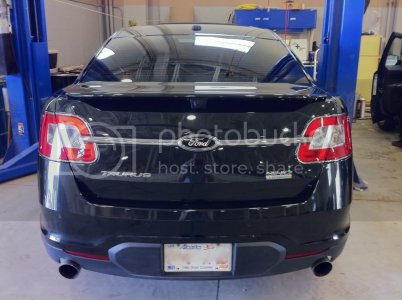

Well, the new emblem has been attached! It was easier than I expected..... I simply took a flathead screwdriver and gently pulled off the stock emblem. It came off with no trouble whatsover and the pins pulled out nicely. I snipped the pins off of my emblem with a pair of tin snips and simply stuck the new emblem on with the adhesive material that was on it. The adhesive material from the old emblem remained on the car and served as another piece of adhesive to help the new emblem stick.
All-in-all it worked out REALLY well and only took about 10 mins. Check it out.....
4413747e
0e2e99c8
521213e7
1f590038
I'm really pleased :) The pictures don't do it justice. In real life, it's nice to get that blue out of there and just stick with the black and chrome theme. ;)
