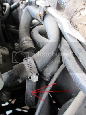

Here is the beautiful bypass job done by the previous owner. The arrow is pointing to the pipe that the leaking hose connects to, thats just the other end.

That bypass hose that was installed by the previous owner is completely kinked. This could create extra pressure in the line, and may have caused the leak. When you fix the leak, make sure you can route that hose differently so that it is not kinked, or find a longer hose. You may have to scour the local parts store for a hose that has the right curve to work as well. In a bind (in the middle of a snowstorm an hour from home) I think I just used one of the heater hoses and looped it back without a kink.
But as far as repairing the other hose, make sure when you are cutting the crimp off that you DO NOT cut the metal piece.
That is all. Good luck!

I ended up getting some heater hose plugs and just blocking off the line at each end and finally getting rid of the goofy looking kinked hose that was installed by the previous owner. All is well in the universe again. As always thanks to all that contributed, may the SHO gods smile upon you.
