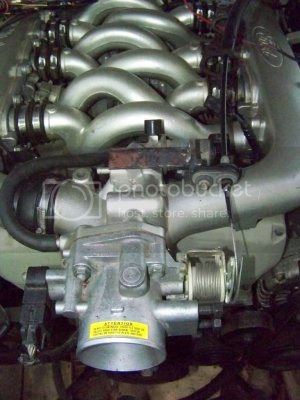

I assume the pic below is the IAC. Should that open port be attached to anything or is it supposed to remain open?
Thoughts? Thanks again, to the folks that are trying to help me out with this. :)

Mine which is a 94. There is a plastic cap on it. Unsure if it is open to atmosphere or a solid cap.

the little port on the iac is vented to atmosphere - normally there is a cap on it to keep the dirt out, but it just vents to atmosphere, so you are okay there.
