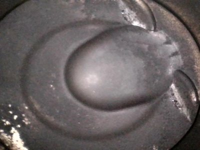

Someone had replaced the ground strap with some tiny wire I changed that to some thick cable I had laying around the shop. And yes average psi is 30 across the board I ordered a borescope to see if the valves hit the pistons….

30 across the board?! I would expect around 160-170, maybe higher depending on wear and build-up. Time to decide if you want to rebuild or replace a motor. Sounds like you got scammed. No way that thing ran and they "just" changed the turbos. I am not even sure how you would get 30. I could see 30 on some and nothing on the others if the chain was busted. If you really want to diagnose further, I would try a leak-down tester. That will at least tell you where all your compression is going. Car-Part has motors starting at $1200 minus turbos since yours were just replaced.

My guess is the timing jumped when it was last shut off. Horrible timing for him unfortunately because he did pay to have brand new turbos put on. The old ones were in the trunk and they were smoked…..I did get the car cheap enough knowing that if it needed a motor it was still worth it. 104k on the clock
