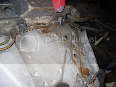

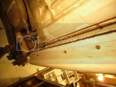

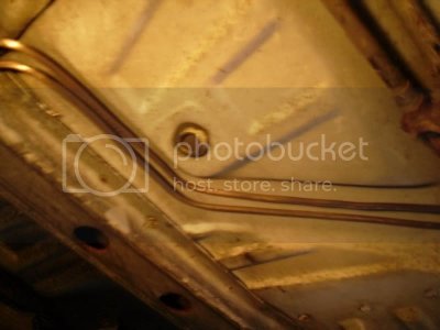

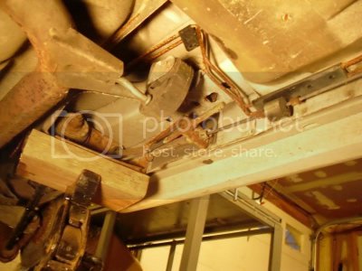

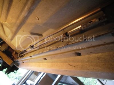

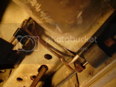

I bought this car(1994 White SHO) for the body because I have a 1993 3.2 mtx that started to rust and was in an accident badly. The 93 has been looked after mechanically but the body is gone. So I decided to keep the White 94 but swap all the parts over. The 94' drove to my house but broke a brake line shortly from moving it around my property.
After doing some research I found that a lot of high end cars and military vehicles use copper nickle brake lines because it withstands corrosion better. I bought some line, bent it into shape and flared the ends.
Brakeline1
Brakeline2
Brakeline3
Brakeline4
Brakeline5
Brakeline6
Sep 6, 2002
2,351
Westerly, RI
Nice work! I Googled the line, looks like Advance Auto can order it in, or it's available online in a 25' coil. The SHO is fine, never sees winter roads, but the truck is going to need lines before this winter. At $50 for a coil, I think I'll give it a try.
How was the material to work with, in terms of bending and flaring?
operdot
Jan 31, 2005
460
25
USA
Its pretty easy I did most of it with my hands wearing welding gloves, however some of the tighter bends I used pliers. I kept the old rusty lines as straight at possible to use as templates. Afterwards I roughed up the surface and painted it with por15. Flaring was a breeze too.
