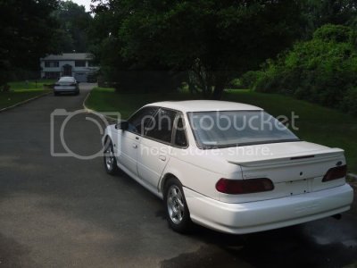

I bought this car(1994 White SHO) for the body because I have a 1993 3.2 mtx that started to rust and was in an accident badly. The 93 has been looked after mechanically but the body is gone. So I decided to keep the White 94 but swap all the parts over. The 94' drove to my house but broke a brake line shortly from moving it around my property.
After doing some research I found that a lot of high end cars and military vehicles use copper nickle brake lines because it withstands corrosion better. I bought some line, bent it into shape and flared the ends.
