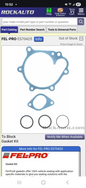

They also come in the water pump mount kit but it looks like RA is out of those at the moment. Stay away from the APEX brand for these o-rings. APEX for everything else is pretty good. Their valve cover set is the best on the market.

Screenshot 20260313 105255 Chrome
