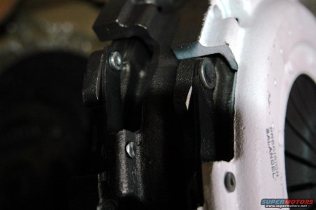

OEM pressure plate on the left. CM1 on the right.
Dsc 0008
The rivets and straps are larger and stronger on the Clutch Masters.
