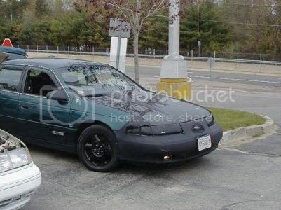

these 2 pics will tell a lot about the car. my front struts definately don't like the hard bang from gas to brake.
and before the swaybar comment, yes my car has some roll but not as much as this guy!
