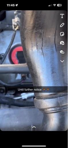

This is the hose that goes to the throttle body with the “noisemaker” it’s cracked baddly to where i see the threading on the inside of the hose. And when i give it full throttle it slowly goes up in rpm could this hose be a main culprit this the only thing i can see so far as a problem

Is it the noisemaker itself or the piece that the noisemaker connects to? If it is the noisemaker, take it off and replace it with a Dorman 02603 Expansion Plug. It's an unnecessary part. I've ran mine without it for years.
Any type of crack like that allowing air to leak should be fixed/replaced ASAP. There's a good chance it's causing your turbo underboost condition.
