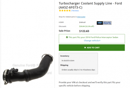

Connected to the throttle body and part of the noisemaker delete:

Texas Marauder
Jul 20, 2007
910
818
Lone Star State

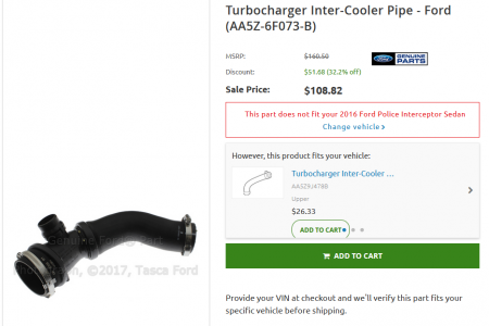

This is the correct part to delete the noisemaker. I have no idea why "coolant" is in the description.

Thanks Texas much appreciated however I was looking for the name which you shared but is wrong as u stated: lol gotta love part descriptions.
