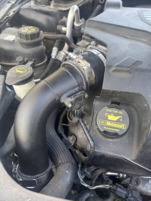

Looks great and no more noisemaker! Old pipe had a split on the underside causing low boost (no underfoot codes, but the BOV’s were cycling under heavy load and lean codes) thanks to Zpak for the hookup I’m much happier than paying for a stock or aftermarket pipe.

Nice man! Glad it worked out. Looks so much better than that ridiculous noisemaker.
I agree. Looking forward to having full boost again. Maybe time for a tune..? Probably not until I get the supporting mods so for now I’ll just focus on reliability. Other than the low boost at the end (after the Colorado mountains I may add) the car did a 4000 mile road trip out west and back with 0 drivability issues.
