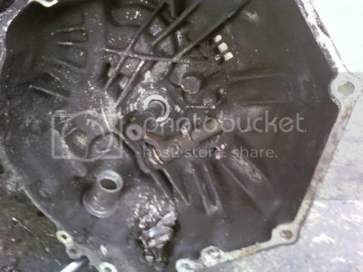

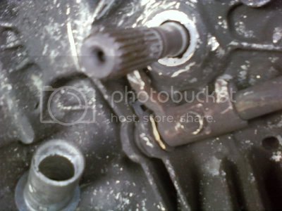

Well guys, it looks like I need a transmission. I guess the Throw out bearing exploded and took out the fork inside the tranny, and the whole sleeve! Let me know if you got one and how much.

Does the bell housing remove from the actual transmission? I see the bolts around it.
Ishodu
Jun 26, 2002
5,077
615
Ontario Canada
Your going to need at least that half of the tranny case. Should be a few around or a whole tranny.
Just remember if you separate the cases, and use just a new half, you have to re-shim the diff in the case.
